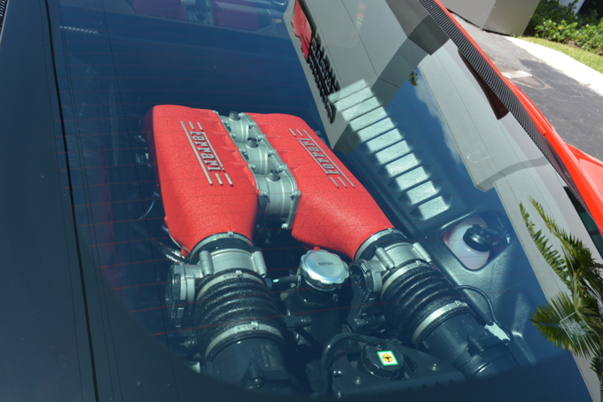

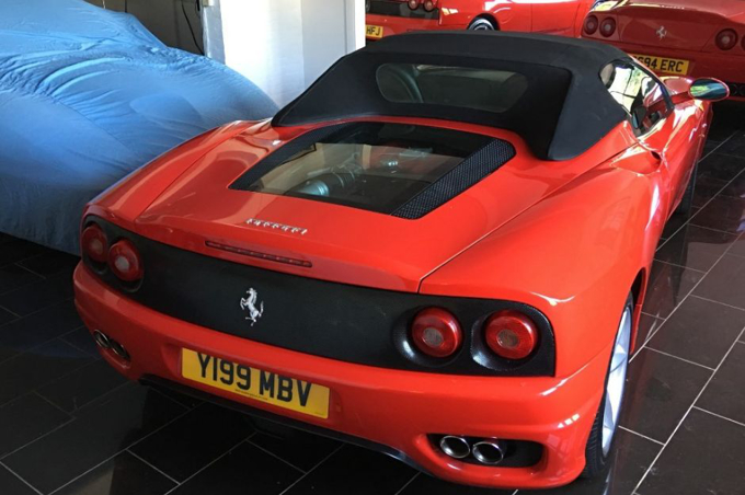

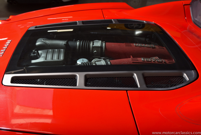

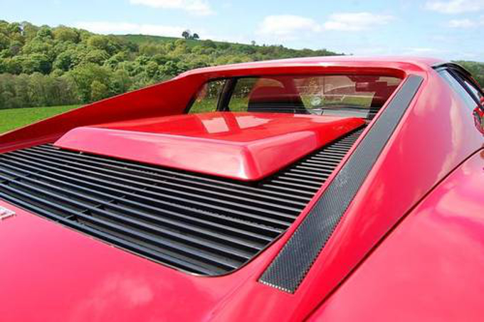

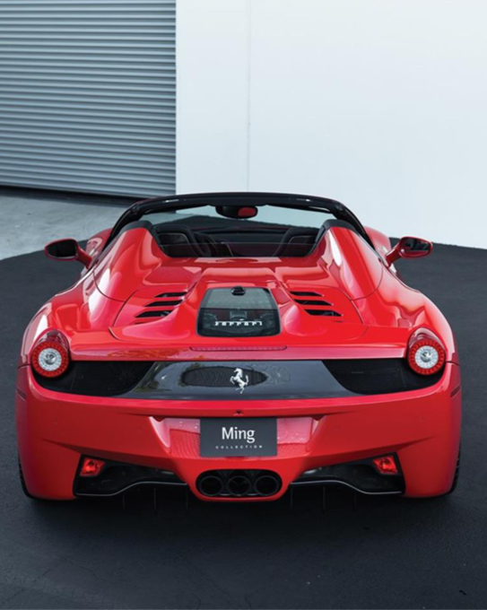

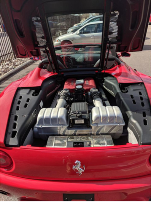

QUOTE(flat4guy @ Mar 22 2023, 06:25 PM) *
Should have made the headers come up and out like an old drag boat so everyone could see them. haha
Or exit out the top like a Carrera GT. All the reports of great sound from reviewers of the day would be replicated plus some on this build. piratenanner.gif

Do like the factory plenum/throttle, but could not believe how heavy it was.
Also…
Could not get over just how low the Italian V8 looked in a 914 without it. chowtime.gif

might just be me but I love the Ferrari on the intakes sticking thru the deck lid. Leaves no question of what is in the engine bay and highlights the uniqueness. With ITB's could be anything from a Porsche/Chevy/Ford/Dodge/Subaru/Toyota/Honda swap, so not nearly as interesting with out a detailed conversation.
In that mind set I am building a ITB system for my -6 conversion that uses 996 manifolds over ITB's. It will be clear that its a Porsche engine but those in the know will scratch there heads with water cooled intake manifolds and air cooled fan on the engine.
