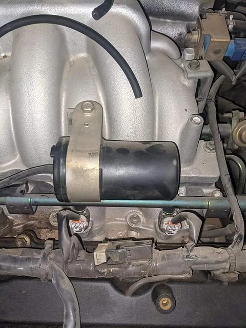

I'll save you a bunch of time.... no on the electronic actuators. It needs to be a quick change, slow will mess up the flow efficiency. It will likely activate dozens of times per mile. Also no on a solenoid as they are not meant to be 'held' and will overheat.
That vacuum canister is HUGE. The one on my Nissan does just a big butterfly and it's soup can sized. You will probably want 2 for the volume of both mechanisms.

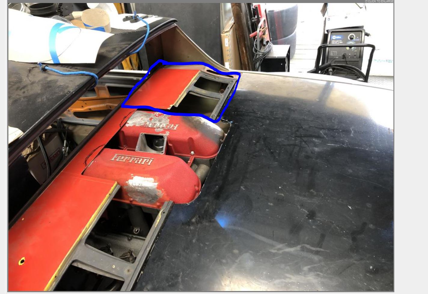

Martin and I spent the afternoon working on closing the original TB openings. I cut the plenum to the desired shape, Martin worked up the paper template and cut the aluminum blank then we took turns working it into shape. Martin's aluminum welding is far better than mine so I happily videoed while he worked his magic. Super happy with how it's coming along.
One tricky piece left to do then repeat on the other side.
tygaboy
The best part is how nice it's going to look in the car. Did I get lucky guestimating the radius I cut in the lid or what? w00t.gif

Here's a sneak peek at some content from the next video:
The driver side plenum partch was mostly in place and we couldn't resist seeing what it was going to look like once it's ready for new wrinkle finish. That top section got final welding, some file work then sanded. Yep, that'll work!
tygaboy
Then it was on to patching the passenger side.
